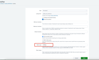

If your "ip" field in the lookup is a CIDR then configure it as an lookup definition (rather than referencing it as <lookup1>.csv and then under Advanced Options set the Match type to CIDR(ip) as below:

The lookup has already been defined. The variable is not really “ip” so in the definition should we put CIDR(ip) because it's an IP or CIDR() to define the variable it should take into account? In both cases, this solution doesn't work. It can't find the IPs in the lookup's CIDRs...
livehybrid
Hi @Treize
In the Match type box you would do CIDR(fieldName) where fieldName is the name of the field in your lookup which contains the CIDR values.
