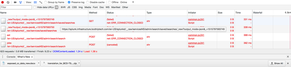

When I attempt to enter very large queries into the search bar I get errors in chrome and eventually a "disconnected" from Splunk popup.
I do not believe the search is ever started as I do not see it in the "Jobs Manager".
Steps to reproduce:
- enter a large query into the search bar, mine is 160 lines and 10.4k characters.
- hit enter key
- errors appear, search is not started, soon "Disconnected from Splunk" popup will appear.
A split second after hitting enter... these errors appears in the chrome debugger:
DELETE https://splunk.myhost.com/en-US/splunkd/__raw/services/search/jobs/rt_md_1516156026.353?output_mode=...
(failed) net::ERR_CONNECTION_CLOSED
GET https://splunk.myhost.com/en-US/splunkd/__raw/servicesNS/admin/search/saved/searches/_new?output_mod...
GET https://splunk.myhost.com/en-US/splunkd/__raw/services/saved/searches/_new?output_mode=json&_=151615...
POST https://splunk.myhost.com/en-US/splunkd/__raw/servicesNS/admin/search/search/ast
and so on....
Errors in Chrome Debugger (this happens right away)
...and then eventually disconnected from Splunk
