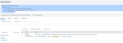

Hi @ganesanvc
Does "text_search" come from a search result - or is this something like a token you are passing in? I couldnt tell from the request but if its coming from a token and you want to apply the additional escaping then you can do this:
index=main source="answersDemo"
    [| makeresults
    | eval text_search="*\\Test\abc\test\abc\xxx\OUT\*"
    | eval FileSource=replace(text_search, "\\\\", "\\\\\\\\")
    | return FileSource ]
Note: I used a sample event in index=main as you can see in the results above using;
| windbag
| head 1
| eval _raw="Test Event for SplunkAnswers user=Demo FileSource=\"MyFileSystem\\Test\\abc\\test\\abc\\xxx\\OUT\\test.exe\" fileType=exe"
| eval source="answersDemo"
| collect index=main output_format=hec
I may have got the wrong end of the stick with what you're looking for here but let me know!
livehybrid
Hi @ganesanvc
    [| makeresults
    | return FileSource ]
| windbag
| head 1
