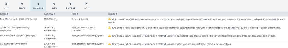

Based on your screenshot, you have multiple compounding issues.
You need to disable Transparent Huge Pages:
https://docs.splunk.com/Documentation/Splunk/8.0.1/ReleaseNotes/SplunkandTHP
Your ulimits are not set correctly and need to be increased:
https://docs.splunk.com/Documentation/Splunk/8.0.1/Troubleshooting/ulimitErrors#Set_limits_using_the...
Your system resources are below the recommendation, which usually means you're running on VMWare.
If correcting the first two issues does not ease the congestion, you may want to consider increasing the parallel ingestion pipelines.
https://docs.splunk.com/Documentation/Splunk/8.0.1/Indexer/Pipelinesets

user789
New Member
I've attached an image - I don't have many hosts reporting to this server, and it looks like I have plenty of ram, even though it's not the recommended number.
