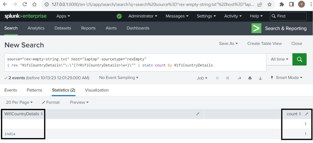

inventsekar
source="rex-empty-string.txt" host="laptop" sourcetype="rexEmpty"
| rex "WifiCountryDetails\"\:\"(?<WifiCountryDetails>\w+)\""
| stats count by WifiCountryDetails
working fine, as suggested previously, check screenshot below..  (pls note the rex command closely.. i have edited ur rex little bit.. i added the ("\"\:\") before rex and (\") after the rex).

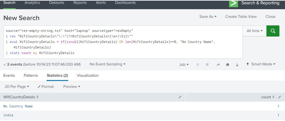

inventsekar
Pls check this SPL:
| rex "WifiCountryDetails\"\:\"(?<WifiCountryDetails>(\w+|\S))\""
| eval WifiCountryDetails = if(isnull(WifiCountryDetails) OR len(WifiCountryDetails)==0, "No Country Name", WifiCountryDetails)

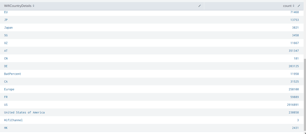

sateesh250795
Loves-to-Learn Lots
there is : in the place of wificountry details ..... its has to fetch as it is.. but it is fetching next field value batpercent in the place of wificountry details.
