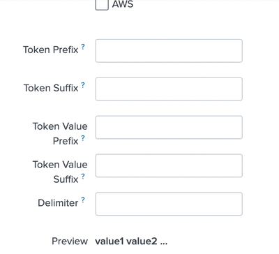

The second part of the analysis will focus on input options that you can set when setting a multiselect inputs as I exemplified earlier.
In your sample code, none of these is set.  In that case, Splunk will use a space as default delimiter, and give no prefix and no suffix.  I have not found the tutorial about input, but definitive information is in input (form).  To help you understand how these choices affect resultant token, I drafted this test dashboard for you to play with:

The third part of analysis is straightforward with search command.  Understandably, if you select "Standard" from a dropdown, or if only Standard is checked, your macro will get the command
search index=1T*
(The search command is implied if it is on the first line.  Otherwise you must write it explicitly.)  Now, if you select "Standard" and "Scada", the macro will get
search index=1T* 2A*
I suspect that you are expecting something like index=1T* OR index=2A* instead.  Is this correct?  One way to do this, obviously, is to set Delimiter to " OR ", and value prefix to "index=".  Note the space before and after keyword "OR" is important.

fredclown
Builder
Another option would  be to set the delimiter to a comma in the multiselect then in the macro use the IN keyword like this ...
index IN ($index_scope$) ... #The rest of the macro# ....
