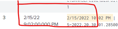

Data:
4/5/2022 9:02 PM | Audit | hi user | something.MoveFiles | Copied File from C:\hello.txt to server/something.txt 4/5/2022 9:02 AM | Audit | hi user | something.MoveFiles | Copied File from D:\reportsSuccess\_CMS.txt to \\server_CMS.txt 12/15/2022 10:02 PM | Audit | hi user | something.MoveFiles | Copied File from D:\reportsSuccess\_CMS.txt to \\server_CMS.txt 4/4/2022 5:00 AM | Audit | hi user | FileSplitter.ProcessFiles | Started Processing : ID 4/4/2022 5:00 AM | Audit | hi user | FileSplitter.ProcessFiles | Started Processing 4/4/2022 5:00 AM | Audit | hi user | FileReader.FileReader | FileReader for D:\reportsInput\tsst.TXT initilized 4/4/2022 5:00 AM | Audit | hi user | something.something. 11/4/2022 5:00 AM | Audit | hi user | something.something. 10/4/2021 5:00 AM | Audit | hi user | something.something.
12/15/2022 is taking as 2/15/22. Below is the props.conf am using it.
SHOULD_LINEMERGE=true
LINE_BREAKER=([/r/n]*)[0-9]+\/[0-9]+\/\d{4}\s[0-9]+:[0-9]+\s[P|A]M
TZ=EST
TIME_PREFIX =^
BREAK_ONLY_BEFORE=[0-9]+\/[0-9]+\/\d{4}\s[0-9]+:[0-9]+\s[P|A]M
Can you please help me to get the correct parsing?  Thanks in advance.

venkatasri
Your TIME_PREFIX = ^ that means starting of the event, what you have highlighted is not being considered as _time for that reason.
When you set TIME_PREFIX alone, starting of the event is 4/5/2022 9:02 PM assuming line_breaking is fine.
you should look at TIME_FORMAT and set the TIME_PREFIX correctly for the timestamp you want to consider for _time.
The screenshot and events pasted looks completely different.
