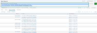

Query 2
eventtype=axs_event_txn_visa_rsp_formatting
| rex field=_raw "(?s)(.*?FLD\[62-2 Transaction Ident.*?DATA\[(?<F62_2>[^\]]*).*)"
| stats values(txn_uid) as txn_uid, values(txn_timestamp) as txn_timestamp, by F62_2
What I really want is the output of the for query 1 and pass as an input to query, common field between two queries is F62_2.
if i run the query it would be different output, so basically two queries should be combined and when it run it should take from F62_2 from query 1 and produce values(txn_uid) as txn_uid, values(txn_timestamp) as txn_timestamp
