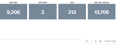

I am trying to add the extra column for totals. If you observe above picture, I have four counts  of domain and now i need one more column which gives sum of all the above columns and it should be seen in dashboard
I need to get output of field domain in this form
Can you please help me to find the solutions.

Hi @renuka,
You have to create a Post Process Search containing your full search (without addcoltotals).
e.g.:
| stats count BY CRS_Domain
and in each panel call the base search adding an additional search filtering in each panel put a final filter, e.g. if your base search is called "basesearch", in the "V&V" panel you'll have:
<search base="basesearch">
     <query>
          | search CRS_Domain="V&V"
          | table count
     </query>
</search>
instead in the last panle (total), you have to add:
     <query>
          | addcoltotals labelfield=CRS_Domain label="Total"
          | search sourcetype=Total
          | table count
     </query>
</search>
If you want to better understand how Post process Search works see at https://docs.splunk.com/Documentation/Splunk/8.2.0/Viz/Savedsearches#Post-process_searches_2 or see the Splunk Dashboard Examples App (https://splunkbase.splunk.com/app/1603/).
Ciao.
Giuseppe

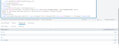

renuka
@gcusello
 They are similar
 I tried adding addcoltotals which actually giving me the sum of all the above but  in visualizaton i couldn't display all four value count and total

Hi @renuka,
e.g.:
     <query>
          | table count
     </query>
</search>
     <query>
          | table count
     </query>
</search>
Ciao.
Giuseppe
