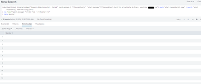

Here's the actual Search I am running:
Just let me know if more details are needed, and thanks again.

gcusello
Hi @tdavison76 ,
please try this regex:
| rex field="alert.message" "On-Prem - (?<your_field>[^\"]+)"
that you can test at https://regex101.com/r/RWQr9a/1
Ciao.
Giuseppe
