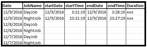

I want the output in the following format:
The individual queries are working,
source="*Batch_Logs*" "*Starting*"
| rex field=_raw "(?P<startDate>\d{4}\-\d{2}\-\d{2})\s(?P<startTime>\d{2}\:\d{2}\:\d{2})(?P<batchJobDescription>.*)"
source="*Batch_Logs*" "*completed*"
    | rex field=_raw "(?P<endDate>\d{4}\-\d{2}\-\d{2})\s(?P<endTime>\d{2}\:\d{2}\:\d{2})(?P<batchJobDescription>.*)"
When I try append/appendcols/join, Only startDate and startTime gets extracted. endDate,endTime do not get extracted, nor am I able to see events with 'completed'.
source="*Batch_Logs*" "*Starting*"  | rex field=_raw "(?P<startDate>\d{4}\-\d{2}\-\d{2})\s(?P<startTime>\d{2}\:\d{2}\:\d{2})(?P<batchJobDescription>.*)" | append
    [search source="*Batch_Logs*" "*completed*"
    | rex field=_raw "(?P<endDate>\d{4}\-\d{2}\-\d{2})\s(?P<endTime>\d{2}\:\d{2}\:\d{2})(?P<batchJobDescription>.*)"]
What am I doing wrong? Please tell me the correct query to get the format in the table, and also to calculate duration.
