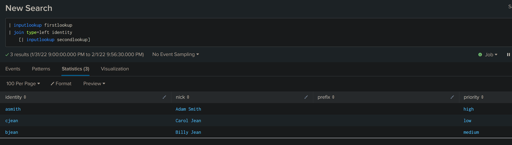

| inputlookup firstlookup
| join type=left identity
    [| inputlookup secondlookup ]
This will accomplish what you are trying to do. If secondlookup doesn't have a priority then the priority from firstlookup will be present.  If you want to ignore the initial priorty complete in firstlookup just do:

ITWhisperer
| lookup firstlookup
| rename priority as default_proirity
| lookup secondlookup
| eval priority=coalesce(priority,default_proirity)
| fields - default_priority
TheLawsOfChaos
So this is close, but think you want inputlookup instead:
| rename priority as default_priority
| eval priority=coalesce(priority,default_priority )
ITWhisperer
You probably don't want inputlookup, certainly not two of them, they are generating commands. I was assuming there was already a search ahead of the lookups I was proposing, and this solution was to reset the priority found by the first lookup with the priority found by the second lookup where it was available (which seemed to be the essence of the original question).
TheLawsOfChaos
They are trying to combine one csv/lookup with the values of a second lookup.
If you were going to go the lookup route you would do the generating search, then run the lookup against the 'correct' priority data, to return the correct priority as something like 'new_priority', and then coalesce on that.
