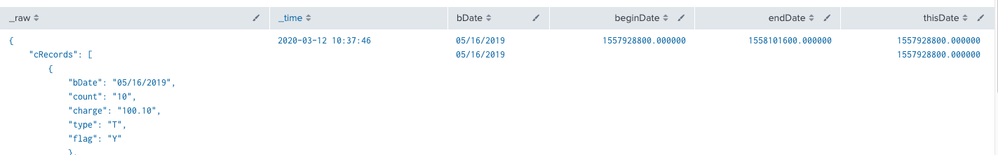

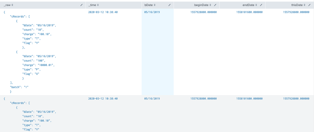

What you need is an | spath output=bDate path=cRecords{}.bDate| mvexpand bDate
Before mvexpand:
After mvexpand:
Then upon execution of the query, you'll get the desired outcome for the above posted JSON.
