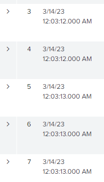

I have a 2015 log that I need to analyze
I have a 2015 Aruba log I need to analyze. The log does not have the year, so Splunk inputs the current year (2023). Is there a way to adjust the year? Here is a sample of my log (IP, MAC, and Name of Devices are XXX out).

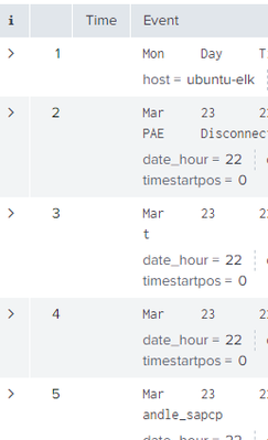

Here is what Splunk has

Thank you. The year changed, but not correctly.

index="XXXX"| eval _time=strptime("2015 "._raw,"%Y%b%d %H:%M:%S")
I get the following. The time is blank.

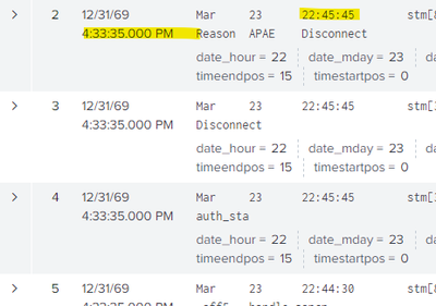

2nd try, I added another eval command. I get this the year as 1969 and the time is off.
index="01-aruba"| eval _time=strptime("2015"._raw,"%Y%b%d %H:%M:%S")
| eval _time="2015"
