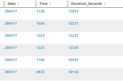

I've a field Duration_Seconds to establish length of calls going through the system. I'm trying to display say the top 20 longest calls, however, whatever I try, it basis the results on total count, not length.
So even if I have a hundred calls at 30 seconds long that's not what I'm after, I,m after the individual call at 12257 seconds, 10545 seconds, 10140 seconds etc. However, if I have 5 calls at 900 seconds, I still need to see those as separate instances.
Does that make sense?
The search I'm using is:
host=*|search Code_Dialled=9 Duration_Seconds=* |sort - "Duration_Seconds"
which gives me it as a search, it's the last bit I'm stumped on.

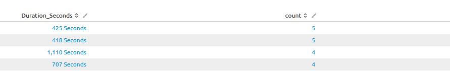

Hi thanks for getting back. It gives pretty much what i already have. The issue is when I try and chart it say using top 100 "Call_Duration" it goes back to giving me the top number by count, so I have 5 calls at 425 seconds as my number one in the chart. I'd ideally like to show say the top 20 / 50, so if I have 5 calls all at 999, they are all shown as individual calls.
So if I search it give me the below, which is perfect.
But what I actually get using, say Top 20.... is
Hopefully this makes a little more sense
