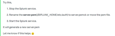

On November I had a problem with Mongo DB and I tried this solutions:
https://community.splunk.com/t5/Knowledge-Management/Why-are-we-getting-these-errors-KV-Store-Proces...  --> doing this I noticed that permissions of files inside this folder have changed. May this be the cause of the problem? This solutiion didn't work
- I solved the problem doing this
Could you help me please?
Thank you
