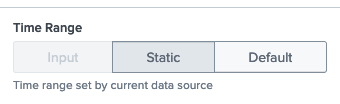

for some reason is not bring all the records, and this time range doesn't make any affect to the result:
What's is the right way to use this object and bring the total count of the records in the last 30 days?
