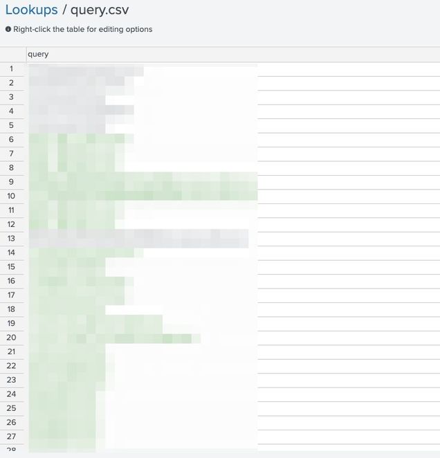

Sunjux
Hi, @rnowitzki
I tried the search syntax you provided,and the results are shown below :
I think the cause of the problem is that 「type_of_csv_query」 shows 「invalid」,
These csv files were uploaded using Lookup Editor after saving a new file through search syntax. Is this caused by this?
Thank you for your assistance, I think my question is getting clearer.
Thanks again.
rnowitzki
Builder
Hi @Sunjux ,
Ugh, that is strange, I don't know what kind of data would result in "invalid" for the typeof() function.
Is there no visible difference between query and csv_query? Maybe one of them in quotes and the other not or something like that?
What you could try is to transform both of them to string. But I am not sure if it works with the csv_query in that case.
