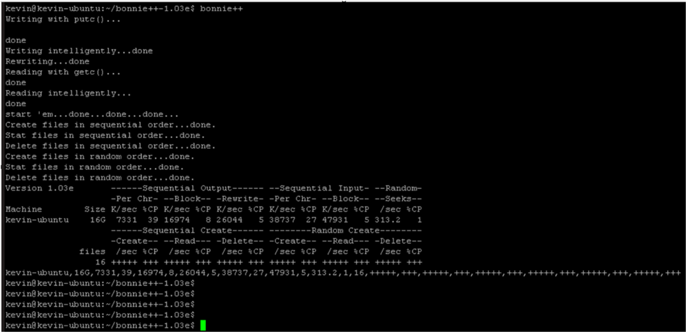

I have install bonnie++  Ver 1.03e on Ubuntu 20.04.4, try to run Command bonnie++ , attached please fine the output screen shot.
May I know how to calculate or check the IOPS from this bonnie++ output ? should it be just last column > Random > 313.2 /sec ?  thank you !

Well, the IOPS is a very interesting metric because it can be sooooo skewed depending on where you measure it and what you take into account.
Yes, there is indeed the number of 800 "sustained IOPS" explicitly provided in https://docs.splunk.com/Documentation/Splunk/8.2.5/Capacity/Referencehardware but there is in no way a more specific method of measurement provided. The recommended measurement tool is FIO, as described in the community article referenced therein but it's not deemed as an "official requirement".
IOPS heavily depend on the request size as well as caching and request queue optimization (reordering) performed on various layers (OS, controller, disk) so it's a very confusing metric.
I'd suppose that due to the fact that Splunk, as any other "normal program" simply uses operating system calls to access files, you'd be mostly interested as "high level" IOPS - after all possible optimizations by all lower levels. It also means that the resulting IOPS may be sensitive to your OS configuration (like data and metadata caching and buffering and queueing algorithms as well as of course - in case of disk arrays - controller cache size and stripe size).

Hi @NSCKevinSplunk,
yes is the value you found:
Random > 313.2 /sec
Anyway, I always used Bonnie ++ but on internet I found this interestibng post about disck performances measurement https://serverfault.com/questions/517051/can-i-determine-iops-on-a-disk-array-using-bonnie and https://github.com/dataPhysicist/iops

Thank for reply and confirmation !
