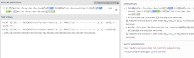

i tried but no matching condition
Test String
++EXT-ID[05] FLD[Wallet Provider Device..] FRMT[TLV] LL[1] LEN[2] DATA[**]
++EXT-ID[0A] FLD[Wallet Account Email A..] FRMT[TLV] LL[1] LEN[64] DATA[E4C55D23036D23E668790A1272C3AABE129096D830532C4301D000FFA2D15062]
++EXT-ID[06] FLD[Wallet Provider Accoun..] FRMT[TLV] LL[1] LEN[2] DATA[**]

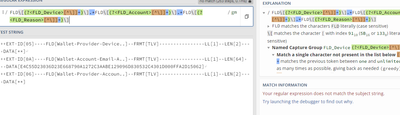

jayeshrajvir
Hi @gcusello
.* would match everything, basically 1st condition
https://regex101.com/r/qXNk4U/1
 I have a logs where
1. the fields highlighted in both blue and red present,
2. only fields highlighted in blue present and
3. field highlighted in red present
I wanted to fetch transactions log where it should fetch fields highlighted in blue is present and field highlighted in red is not present

Did you try my suggestion? Here in a regex command to filter for only the events which match the criteria
| regex _raw="FLD\[Wallet Provider Device\.\.\].+? FLD\[Wallet Account Email A\.\.\].+?(?!FLD\[Wallet Provider Reason\.\.\])"
jayeshrajvir
Hi @ITWhisperer
thanks for your response. Its not working. Please see below
ITWhisperer
It is not working because you have split your event into two lines - try it without the linebreak in the middle
If your events do actually have linebreaks in them, then try adding (?ms) to start of the regex
