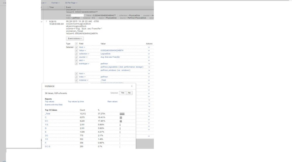

So, I have a field on my log called latency - my bad ; I didn't include it in my earlier snap-shot.
But it does exist.See attachment.
/storage/temp/56231-latency.jpg
Finally, what is the actual result that you want to see? I want to see a graph representation how the the avg. disk transfer value , latency , _time stamp by host using the bar char
Do you want to see the most recent value for some statistics? Yes
Would you like to plot some values over the last 1 minute? Yes
Do you want to update this continuously? When you say update do you mean - run the search over different time period /span?
Is it going to be part of a dashboard, or a report that is run on demand... yes as a report and eventually added to a dashboard.
Thanks for the feedback.
