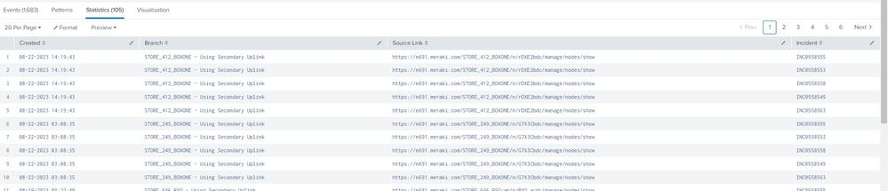

I'm still in the learning process of Splunk searches and I have been tasked to create a table that contains only open transactions based off of "where closed_txn=0".  But also join a Service Now Incident # to the each row in the table.
I've been bumbling around, testing and failing on this one.  I've got it to a point where the table is only showing the open transactions, but it is being duplicated for every incident # for ServiceNow.
Below is the Search I am using, I've probably did this all wrong 🙂

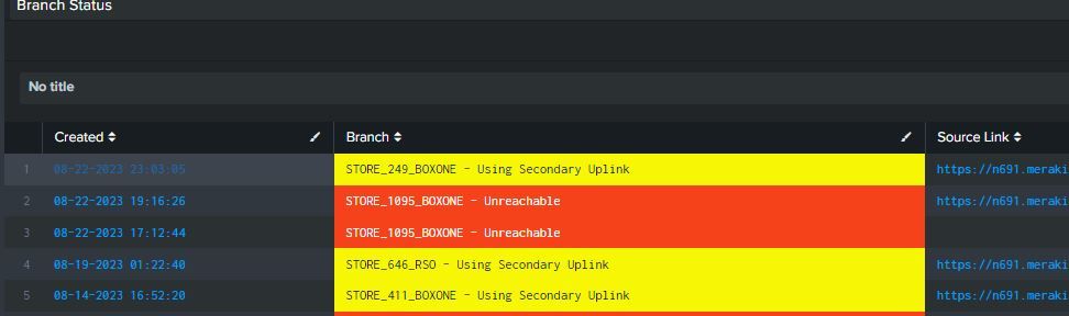

Thank you both for all of the advice, really appreciate it.  I've basically have been trying to piece this together from a lot of googling. My objective is the following:
I have a Dashboard table that displays only the 'Create' events using the following Transaction Search.
integrationName="Opsgenie Edge Connector - Splunk", alert.message = "STORE*", alert.message != "*Latency" alert.message != "*Loss" action != "AddNote" | transaction "alert.id", alert.message startswith=Create endswith=Close keepevicted=true | table _time, alert.updatedAt, alert.message, alert.alias, alert.id, action, "alertDetails.Alert Details URL", _raw, closed_txn, _time
| where closed_txn=0
| rename alert.message AS "Branch"
| rename "alertDetails.Alert Details URL" as "Source Link"
| eval Created=strftime(_time,"%m-%d-%Y %H:%M:%S")
| fields Created, Branch, "Source Link"
| sort by Created DESC
| fields - _raw, _time
I have been asked to add a ServiceNow Incident # to this table. I was able to get the join working with the following Search
(integrationName="Opsgenie Edge Connector - Splunk" alert.message = "STORE*") OR (sourcetype="snow:incident" dv_opened_by=OPSGenieIntegration)
| eval joiner=if(integrationName="Opsgenie Edge Connector - Splunk", alertAlias, x_86994_opsgenie_alert_alias)
| stats values(*) as * by joiner
| where alertAlias==x_86994_opsgenie_alert_alias
| rename dv_number as Incident
| table alertAlias, Incident
| fields alertAlias, Incident
But I'm stuck on joining those two searches together to display in a table, the Created, Branch, and "Source Link" from the Transaction search, the Incident from the Join search, and only for the open transactions.
