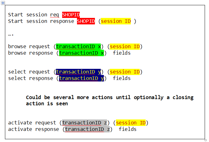

I have some events representiong a customer’s interaction with one of my company’s applications. The typical flow is that the customer: starts a session, browses offers, selects a product and hopefully activates it. This is shown in the attached diagram.

I know you said above that you were hesitant to pursue full field extraction for these events, but I think it's your best (and most scalable) option in the long term. Putting in the time now to build those extractions will allow you to quickly navigate the logs now and in the future. Lots of folks here will be happy to help you build field extractions if you post some sample events (preferably with as little obfuscation as necessary to mask sensitive data).
If you are able to get the field extractions done - and if the values of x, y, and z are globally unique, then this should work for getting the value of the field "session ID" applied across all events in the diagram above:
your base search
| eventstats max('session ID') AS "session ID" BY SHOPID
| eventstats max('session ID') AS "session ID" BY transactionID
After that, you can more easily do analysis on the grouped events.
