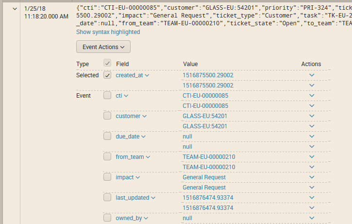

Hello all,
I've been trying to get some stats from JSON data that I've been receiving in Splunk.
See:
I think I'm not getting the stats because the events are multifield and it is all repeated.
See the search here in case is needed:
sourcetype=api_in_tasks to_team=TEAM-177 "TK-EU-28209292.1.1"   | dedup task consecutive=true | rex field=task "(?<ticket>\w[\w\-]*)" | join type=inner ticket [search sourcetype=api_in_tasks from_team=TEAM-210| rex field=task "(?<ticket>\w[\w\-]*)" | dedup task consecutive=true | rename created_at as created_at_ticket | fields ticket,created_at_ticket ] | eval ticket_created=strftime(created_at_ticket,"%m/%d/%y %H:%M:%S") | eval diff=created_at-created_at_ticket | eval diff_time=strftime(diff,"%m/%d/%y %H:%M:%S") | eval created_task=strftime(created_at,"%m/%d/%y %H:%M:%S")  | table task,ticket,created_task,ticket_created,diff_time, created_at_ticket
Here another photo from the data:

Looking back at some of your comments, I noticed the following:
INDEXED_EXTRACTIONS = json
If on top of these indexed extractions KV_Mode is left to the default auto setting, would Splunk run KV extractions again on searchtime, adding on to the values extracted as indexed extractions?
Can you try either removing that INDEXED_EXTRACTIONS = json, or adding KV_Mode=none in props.conf?

marina_rovira
Contributor
I've tried both options with two different indexes (incoming tasks and out coming ones) and here you have the results:
For the in ones, I've added KV_MODE=none
It is working now!
I can see all the fields with calculations filled with results and the events only contain one line.

In the out ones, I've deleted INDEXED_EXTRACTIONS = json
And the events are empty, they are just these characters "},{"
So, the right one is to include both,
KV_Mode=none
Can you give more information or explain me a little more about the KV_MODE?
Why was it happening? So if I find the problem again I will understand it better. Also, post an anwser so I can click as right answer an upvote it!
Thank you a lot!

FrankVl
Ultra Champion
From the screenshot in your question, the event seems to be a single event, right? It is just the field extractions that are duplicated somehow?
Did you write custom field extractions and also left KV_Mode to its default setting (auto)?

FrankVl
Ultra Champion
KV_Mode (configurable in props.conf) instructs Splunk how to automatically extract key value pairs from events. In this case Splunk will detect this as JSON data and automatically extract the fields and their values.
I'm trying to understand why Splunk in your case duplicates the values for each of the fields...
