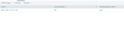

The final output should look something like this
The table before the final stats aggregation looked like this and show more context around what the streamstats are doing here.
Note: For this method to work properly _timestamps of each process event shouldn't be exactly the same, there would need to be some sort of step up in time to the next event (event if it is milliseconds). This is because we need the events in the correct sequence for the streamstats to work as expected.
