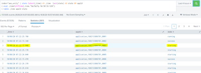

shivaguthi
Hi @gcusello
take a look at the yellow highlighted row it's  state is "starting", i see the latest timestamp. Actually state should be "success" in the above result
but I wonder if I look at that event it's  state is "success" as shown below.
gcusello
hi @shivaguthi,
only one question:
in the screenshot is appId application_xxxxxxxx_000x?
could you share a sample with the same appId?
Ciao.
Giuseppe
shivaguthi
hi @gcusello
below is the sample data,  same appId but
different time stamp, state(success, running,running)
below reocrd has latest time stamp which has state as success - this is expected to come in search
what actually coming already in above

gcusello
Hi @shivaguthi,
let me understand: the problem is that the order of the events isn't a time order, but, (in you example), this event
10/8/20
9:22:37.220 AM
INFO: got response from the livy LivyResponse [id=1, appId=application_1602141094791_0003, state=running, status=null, name=Copy-x-2020-10-08, appId = application_1602141094791_0003log = [state = running
could be the last in order of arriving but not the latest in time,
Is this correct?
If this is you problem, you could run something like this:
your_search
| eval my_state=_time."|".state
| stats latest(_time) AS _time values(source) AS source values(name) AS name max(my_state) AS my_state BY appId
| eval _time=strftime(_time,"%m/%d/%y %H:%M:%S.%3N")
| rex field=my_state "[^\|]+(?<state>.*)"
| table _time source name appId state
Ciao.
Giuseppe
