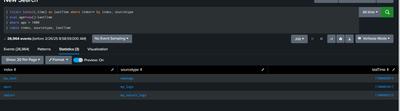

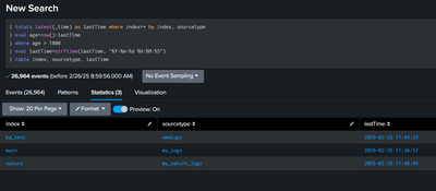

| tstats latest(_time) as lastTime where index=* by index, sourcetype
| eval age=now()-lastTime
| where age > 7776000
| eval lastTime=strftime(lastTime, "%Y-%m-%d %H:%M:%S")
| table index, sourcetype, lastTime

@harishsplunk7
Try this, you can change the age value to 7776000 (90days)
Did this help? If yes, please consider giving kudos, marking it as the solution, or commenting for clarification — your feedback keeps the community going!
harishsplunk7
the query is not getting expected result,  I need to get the list of index which is not used by anyone
