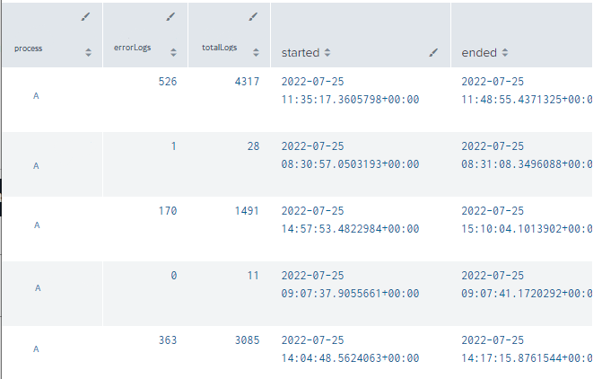

din98
@kamlesh_vaghela
here is the sample.
kamlesh_vaghela
@din98
Can you please share all sample events as well with the timestamp, error logs, and successful logs? This will be helpful to suggest proper solution.
