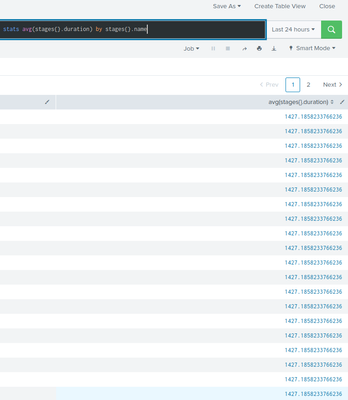

The SPL is returning multiple jobs, yet the stats of the avg(stages{}.duration) is that the average is the same for each stage.

I am using avg(stages{}.duration) and the averages aren't making sense. They are all in the same range when I know there are stages that take very little time on average.

My jobs have multiple nested stages{} each with a name and a duration and children. Doing this:
spath path=stages{} output=extracted_stages
Gets me a new field with a block of stages. mvexpand seems to do nothing. If I generate a table with just the extracted_stages, I see the same table. Unfortunately, I can't really post the full copy/pasta because of corporate guidelines.
In my current example, I just want the duration of the "top-level" stages{}, not their children. I think the avg(stages{}.duration) is non-sensical, because I have an initial stage "Prepare" that takes never more than a couple of seconds, yet when I display the average it is in a range result that is similar to all the other stages, which makes me think that somehow the average may be getting coalesced in a way that doesn't make sense.
