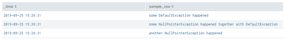

Say you have these raw logs (as you mentioned above)
| makeresults
| eval sample_raw = "some DefaultException happened,some NullPointerException happened together with DefaultException,another NullPointerException happened"
| makemv delim="," sample_raw
| mvexpand sample_raw

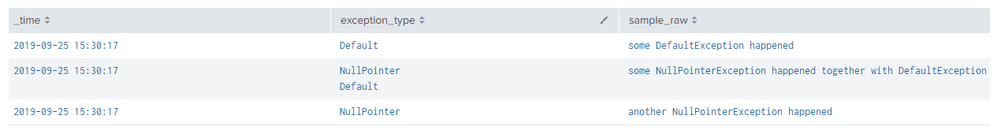

The important thing to consider here is to count the occurence of "Exception" in your raw log. In order to do that, we need to capture the exceptions as multivalue field like this (or by adding this line of rex)
| rex field=sample_raw max_match=0 "(?<exception_type>[\w]+)Exception"
As a result, it will create an MV field containing all the Exceptions like this:
From here, you can just easily filter out the ones you don't like using the | where command:
| where mvcount(exception_type) > 1 OR exception_type != "Default"

morethanyell
Builder
| makeresults
| mvexpand sample_raw
I think this is just one approach. There might be better ways to do it.
franjo
mvCount > 1 was not always good, but if I use this then I get what I want:
where mvcount(mvfilter(exception_type != "Default")) > 0
morethanyell
Builder
That is a lot better
