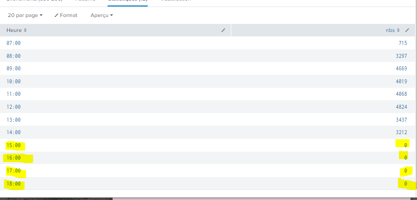

jip31
Motivator
correct but what I dont like with this is that it displays _time which didn't occured
for example I displays 14h, 15, 16h with 0 result but I would like to display 0 results only for previous hour than current hour

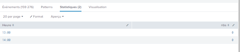

ITWhisperer
If you set earliest to -1h@h how are you getting results for more than an hour ago?
Can you show the search you are using for these results?
jip31
Motivator
I just have this
ITWhisperer
