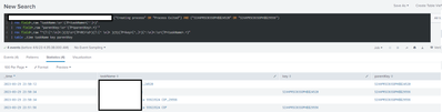

Hi,
we have to monitor some jobs in which One Job could have multiple sub task.  It could be nested dependency as well.  One task depended on other and that other dependent on some other....
I am looking to correlate these dependency and want to see how much time job took end to end.
In below example.
1st task dependent on 2nd, 2nd dependent on 3rd, 4th is End of task.

Good pointer.  In fact, I started with two levels (as the screenshot shows):
| eval u_key = if(isnull(key), parent_key, key)
| transaction u_key startswith="eval(isnull(key))" endswith="eval(isnull(parent_key) OR key == u_key)" keepevicted=true
| foreach parent_key mode=multivalue
    [eval uu_key = mvappend(uu_key, if(mvcount(parent_key) < 2, <<ITEM>>, if(key == <<ITEM>>, null(), <<ITEM>>)))]
| eval _time = if(u_key == uu_key, _time, _time + duration)
| rename duration as duration1
| transaction uu_key startswith="eval(key!=uu_key)" endswith="eval(key==uu_key)" keepevicted=true
| eval duration = sum(duration1) + duration
Then, I realize that each additional nest requires an additional explicit compaction.  Very ugly indeed.
Anyway, here is an emulated dataset to test the above:
_timekeyparent_key
2023-03-29 07:26:0067890
2023-03-29 07:06:00 67890
2023-03-29 06:30:001234567890
2023-03-29 06:04:00 12345
Speaking of test dataset, the OP should always provide that in text.  Screenshot is very unhelpful.
