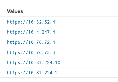

All,
Anybody got idea on the below selected fields on how convert to FQDN? Seems lookups/dnslookup are not possible because of https on the selected fields.
Hope somebody can help 🙂 Thanks in advance
PrewinThomas
Motivator
@jfmph_
You need to remove those https and keep ip to perform lookup.
| eval ip=replace(YOUR_FIELD,"https://","")
This will remove https and keep ip, now use dnslookup to retrieve hostname.

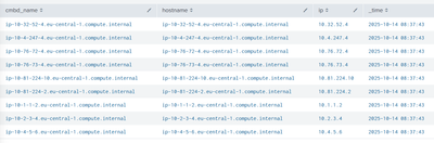

akkoem
I would first regex out then do DNS lookup to a separate field followed by coalesce in case DNS server doesn't know the host name. Here is the SPL with make results:
| makeresults
| eval ip_list="https://10.32.52.4,https://10.4.247.4,https://10.76.72.4,https://10.76.73.4,https://10.81.224.10,https://10.81.224.2,http://10.1.1.2,http://10.2.3.4,http://10.4.5.6"
| makemv delim="," ip_list
| mvexpand ip_list
| rex field=ip_list "https?\:\/\/(?<ip>[\d\.]+)$"
| lookup dnslookup clientip AS ip OUTPUT clienthost AS hostname
| eval cmbd_name=coalesce(hostname,ip)
| fields cmbd_name hostname ip

Thanks, the output below shows as per your suggestion and not sure if our Splunk unable to query DNS as it's not showing the correct FQDN.
akkoem
according to screenshot, it queried DNS server and returned cloud native names. From the table fields, IP is queried against and hostname returned. cmdb_name is just a new field in case DNS lookup doesn't return anything.
