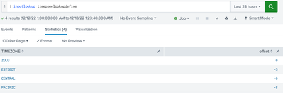

To illustrate, I have made a sample lookup "timezonelookupdefine" with these four:
TIMEZONEoffset
ZULU0
EST5EDT-5
CENTRAL-6
PACIFIC-8
(I'm using a simple offset for EST5EDT here.  Handling daylight savings time will drain your brain, as it has drained many a developers'.)  Then, I run the following against your sample data:

DATE_CONDITIONSDAYS_OF_WEEKEXCLUDE_CALENDAREXIT_CODEJOB_GROUPJOB_NAMEJOIDLAST_ENDLAST_STARTNEXT_STARTNTRYRUNTIMERUN_MACHINERUN_NUMSTATUSSTATUS_CODETIMEZONEoffsetENDTIMENEXTTIMESTARTTIME
1mo,tu,we,th,frEST-NYSE-HOLIDAYS-656PMTPNC-PMT-UI-DATA-CACHE-REFRESH-GMAG-FUNDS11982916705791640167058540001670579164 403234100ACTIVATED9EST5EDT-52022-12-09 01:45:59 (EST5EDT)2022-12-09 03:29:55 (EST5EDT)1969-12-31 15:59:55 (EST5EDT)
