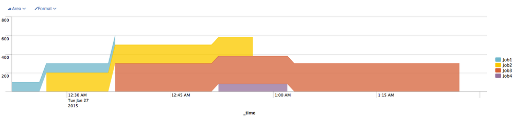

alt textWell, you need to hack it a bit further to get those timechart buckets filled correctly.
<your search here> | eval endtime=_time+JobRunTime*60  | timechart max(MemberCount) as Count max(endtime) as maxT by JobName | rename "Count: *" as *  | rename "maxT: Job*" as max* | filldown | foreach Job* [eval <<FIELD>>=if(_time<max<<MATCHSTR>>, <<FIELD>>, '')] | fields - max*
Select Area chart and Format it as Stacked and Connected.alt text

This is very helpful. If I directly apply this, it only stacks count up, never takes away after JobRunTime. Why so? My data have a lot more jobs, but I have set limit=0 in timechart already.

Not sure what "only stacks count up" means. The chart above was produced by applying the search on a table as below.

I mean the graph you obtained using the sample data in the question is perfect. But I cannot get the same result on my real(ish) data; member counts simply add up and up, so the total becomes a monotonic increase. Something I haven't understood about the use of <> and so on, I guess. Using 4 jobs of same member count, each lasting close to 4 hours consecutively, I expect a flat stripe with different colour bands. Instead, the bands just add up one after another to form a horn-like shape. (I cannot use graph.)
