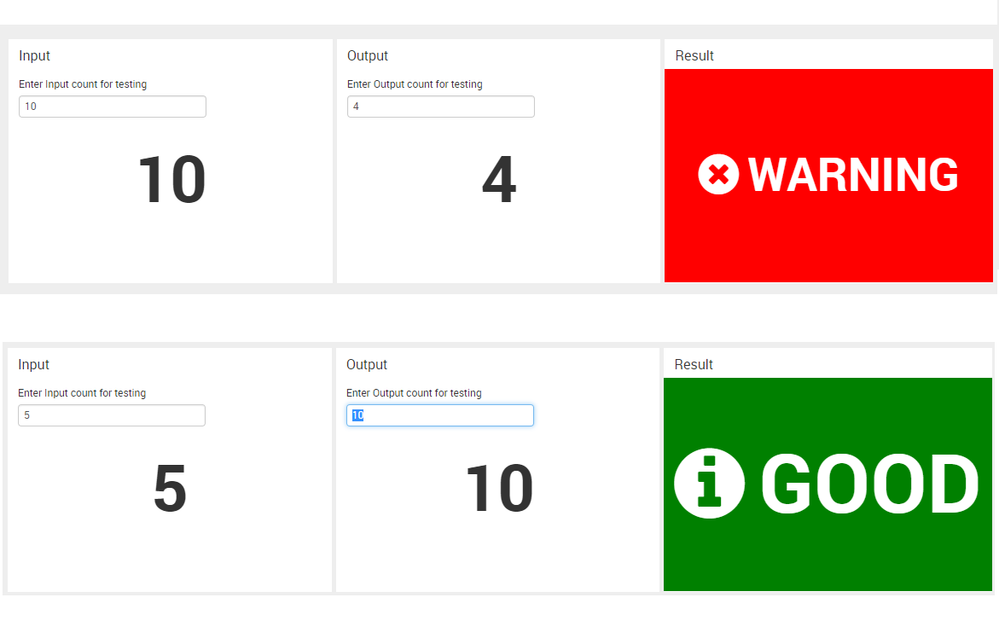

While the simple XML I have provided is for results to be displayed in third panel via a Table with Color ranges, you can get Status Indicator Custom Visualization which can display the same with Color Icon and Text message. Following is code for third panel in case you have Status Indicator Custom Visualization available.
    <panel>
      <title>Result</title>
      <viz type="status_indicator_app.status_indicator">
        <search>
          <query>| makeresults
| fields - _time
| eval diff=if($tokInput$>=$tokOutput$,$tokInput$-$tokOutput$,$tokOutput$-$tokInput$)
| eval message=if(diff>5,"WARNING","GOOD")
| eval icon=if(diff>5,"times-circle","info-circle")
| eval color=if(diff>5,"red","green")
| table message icon color</query>
          <earliest>$tokTime.earliest$</earliest>
          <latest>$tokTime.latest$</latest>
        </search>
        <!-- No changes required for this query -->
        <option name="status_indicator_app.status_indicator.colorBy">field_value</option>
        <option name="status_indicator_app.status_indicator.fillTarget">background</option>
        <option name="status_indicator_app.status_indicator.fixIcon">warning</option>
        <option name="status_indicator_app.status_indicator.icon">field_value</option>
        <option name="status_indicator_app.status_indicator.precision">0</option>
        <option name="status_indicator_app.status_indicator.showOption">1</option>
        <option name="status_indicator_app.status_indicator.staticColor">#555</option>
        <option name="status_indicator_app.status_indicator.useColors">true</option>
        <option name="status_indicator_app.status_indicator.useThousandSeparator">true</option>
      </viz>
    </panel>
