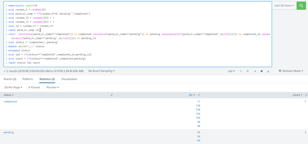

screenshot:
hope it helps

screenshot:
hope it helps
