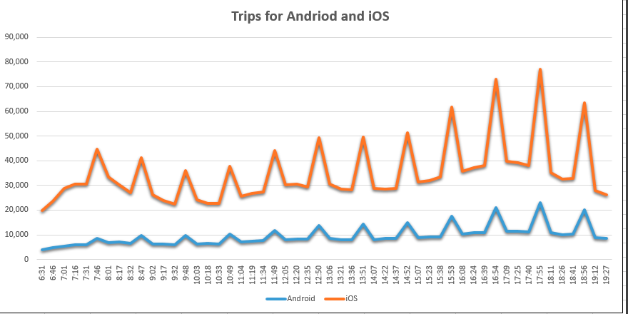

This is how i have data for 24 hrs. When i do 'timechart` the graph bins automatically showing with 4 hrs gap on scale. But i wanted 15m wise points on graph along with the time on x-axis.
please see the below picture for expected output

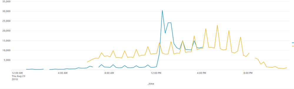

what i am getting is below from timechart command
I want 15m scale on x-axis.can some one help on this?

Can you show the "statistics tab" with _time and values that would be helpful
horsefez
Motivator
Hi @prathapkcsc,
this might help you.
https://answers.splunk.com/answers/91717/timechart-x-axis.html
so for your search that should look like this
...| timechart span=15m fixedrange=true ...
you need to edit the SimpleXML options of the chart on the dashboard, adding the following:
<option name="charting.scaleX">1</option>
<option name="charting.axisLabelsX.majorUnit">P0Y0M0DT0H15M0S</option>
prathapkcsc
I tried this. It didn't work with my dash board.
