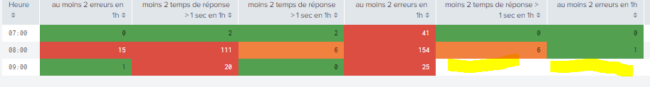

hello
I use appdncols command in order to aggregate in a table the result of different search
I have 2 issues with the 3 fields In yellow
Issue 1
If dont use the piece of code below, the field "Tea" is not displayed (same thing for INC & OUT)
 | appendpipe
        [ stats count as _events
        | where _events = 0
        | eval "Tea"= 0]]
Issue 2
the appendpipe command put only "0" in the first line but not in other

And I have something else strange
As you can, the the results is 0, the results is ususally displayed
But why sometimes I have an empty field instaed 0 like in yellow?
Is anybody can give the solution for displaying the results in any case when the value is 0?

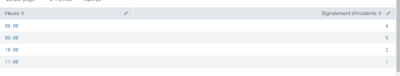

when I execute the search outsite the appendcols
index=test earliest=@d+7h latest=@d+19h
| bin span=1h _time
| eval time = strftime(_time, "%H:%M")
| fillnull value=0
| stats dc(id) as id by time
| rename time as Heure
here is the result
as you can see the first result is at 8:00
But when I execute the code in the gloabl search, the first is result is at 7h... (it's the last column on the right)
How is it possible to have 1h gap?
