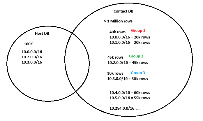

This is just an example:
I have a host table containing IP and hostname, approximately 100k rows with unique IPs
I have a contact table containing IP and contact, approximately 1> million rows with unique IPs
Both can be accessed with DBX query,  but unfortunately they are both located in different DB connections, so it's not possible to join them at the backend.
So, the workaround is to filter out subnet on the contact DB and use subsearches to join the contact DB with the Host DB
Due to 50k rows limit using subsearch, I ran a separate query on the contact DB to find out the number of rows for each subnet, then I grouped them together to make sure the number of rows is below 50k. (Please see the diagram below) Group 1 = 40 rows, Group 2 = 45k rows,  and Group 3 = 30k rows. After that, I used left join for each group on the contact DB with the Host DB.
Since I don't control the growth of data in the Contact DB,  I am trying to figure out a way to get an email alert if one of the groups exceeded 50k limit.
I think I am able to create a scheduled report to produce the stats of each subnet in the group, but going back to my original question:
I simply want to know if it's possible for Splunk to send me an email alert only if it meets certain thresholds.
The subsearch is only one of my cases. Another case is  I have multiple reports that run daily, I intend to read the reports only if there is a problem, such as empty data, meeting certain thresholds, etc.

LearningGuy
Motivator
Hi @PickleRick
Thanks for your help
1.  Like I mentioned, the DB is on a different connection, if it's possible it will take a while until the DB team work on this. So, as a workaround I will need to do this at least to get the data now.
2. Yes 50k is for the join
3. Thanks. Let me look into _internal. The alerting that I am looking for is not only for a case where certain data hits a Splunk's internal threshold, but I also need it for other cases (non-Splunk's internal threshold), for example, if my scheduled report contains empty data or if data hits a certain threshold (max/min).
4.  Sorry, perhaps my explanation in the example is not clear enough because it's difficult to lay it out without a real example in SPL. Both tables (host table and contact table) in the example have been in Splunk and can be accessible via a DBX query. Like I mentioned before, the problem is that we cannot join in the DB; both are on different connections; the table host is in Connection A, and the table contact is in Connection B.
| dbxquery connection ="connectionA"    query="select ip, host from table host"
| dbxquery connection ="connectionB"   query="select ip, contact from table contact"
I did not search remotely on every search, but instead I ran this command for each subnet to find the number of rows. For example 10.0.1.0/16 => 20k rows and so on.
| dbxquery connection ="connectionB"   query="select ip, contact from table contact where ip::inet<'10.0.0.0/16'"
| dbxquery connection ="connectionB"   query="select ip, contact from table contact where ip::inet<'10.1.0.0/16'"
| dbxquery connection ="connectionB"   query="select ip, contact from table contact where ip::inet<'10.2.0.0/16'"
| dbxquery connection ="connectionB"   query="select ip, contact from table contact where ip::inet<'10.3.0.0/16'"
Once I figure the number of rows, then I group them until it hits right below 50k, so I am saving subsearches.  If one subnet above 50k, I will need to split them.   I hope this makes sense.  Note that this is only workaround.
join max=0 type=left ip
[| dbxquery connection ="connectionB"   query="select ip, contact from table contact where ip::inet<'10.0.0.0/16' OR ip::inet<'10.1.0.0/16'"
|eval source="group1"
