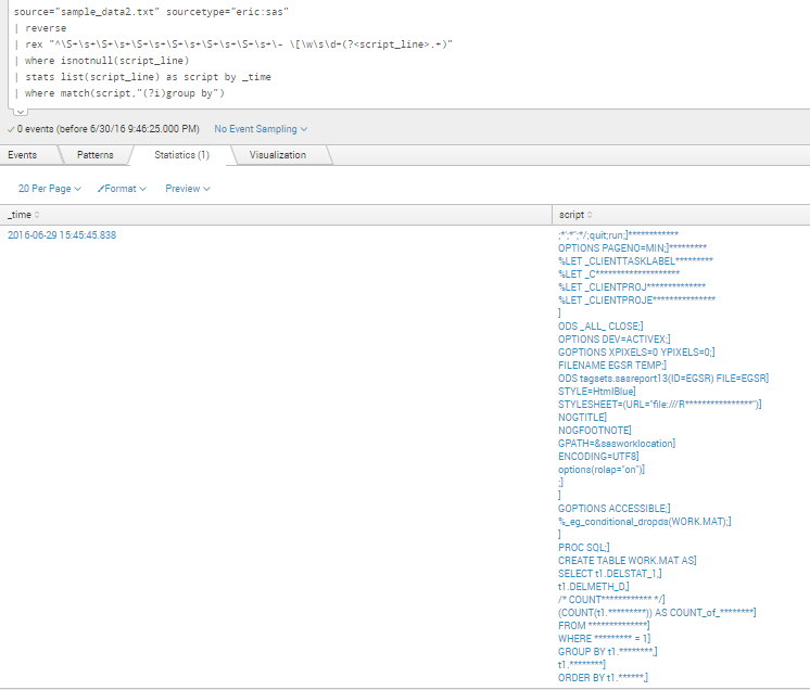

Actually, you may be able to search your logs just as they are. I'm still not sure where the user, but playing with just that sample log entry, something like this might work?
[your search]
| reverse
| rex "^\S+\s+\S+\s+\S+\s+\S+\s+\S+\s+\S+\s+\- \[\w\s\d+(?<script_line>.+)"
| where isnotnull(script_line)
| stats list(script_line) as script by _time
| where match(script,"(?i)group by")
Since splunk will show the "latest" events first, reverse the results so that script is in order (may not actually be needed). In each event, try to use rex to capture a line of the script. I'm very lazy with my regex,I'm sure that could be heavily improved upon.
No filter out events where no script line was found. Then combine the script values by timestamp into one multi-value field called script. I'm not sure how consistently each event of a script will have the same timestamp, but we might be able to do some time manipulation if they're not.
And finally, just look for events where the script matches group by.
I know this is a very limited sample and your actual log data may add more hurdles, but this might be a good start?
