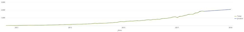

Below is an example of my predict example, search and graph:
... | predict Total as predict future_timespan=12 holdback=0 | fields - upper* lower*
pic of graph with predict function used
It is something I probably need to understand more of, and I am possibly entering the topic of polynomial or exponential types of growth. And maybe this is the case and the answer lies outside of predict.

Note: I could use the upperX values, which would be more arressive(give me higher future values) but again I don't think this will be aggressive enough. maybe I need to look at the forecast option?

An idea of what I got when trying the following
... | fit ARIMA Total order=0-2-7 forecast_k=12
Error in 'fit' command: Error while fitting "ARIMA" model: The computed initial MA coefficients are not invertible. You should induce invertibility by choosing a different model order.
... |fit ARIMA Total order=0-2-0 forecast_k=12
Error in 'fit' command: Error while fitting "ARIMA" model: operands could not be broadcast together with shapes (88,) (0,) (88,)
... | fit ARIMA _time Total order=0-2-0 forecast_k=12
... | fit ARIMA _time Total order=3-1-1 forecast_k=12
I could get this to display something in the graph without errors, not sure of what is doing, but that is more reading up for me to do.
In the meantime could you try and briefly relate the 3 values order needs to my data/graph.
