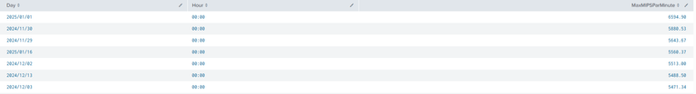

Hello, I'm trying to add up the MIPS of each of the partitions per minute and then keep only the maximum MIPS per day but I'd like to display the time and minutes at which this peak arrived. How do I do it?
Here's my search:
First, I want to make the addition of the MIPS for all partition per minute.
Second, I want to keep only the max value per day of the prior addition.
index=myindex
| bin span=1m _time
| stats sum(MIPS) as MIPSParMinute by _time
| timechart span=1d max(MIPSParMinute) as MaxMIPSParMinute
| eval Day=strftime(_time,"%Y/%m/%d")
| eval Hour=strftime(_time,"%H:%M")
| sort 0 - MaxMIPSParMinute Day
| dedup Day
| table Day Hour MaxMIPSParMinute
Unfortunaly, in my result I loose the hour and minute of when this peak occurs in the day.  Is there a way of keeping the hours and minute value?
