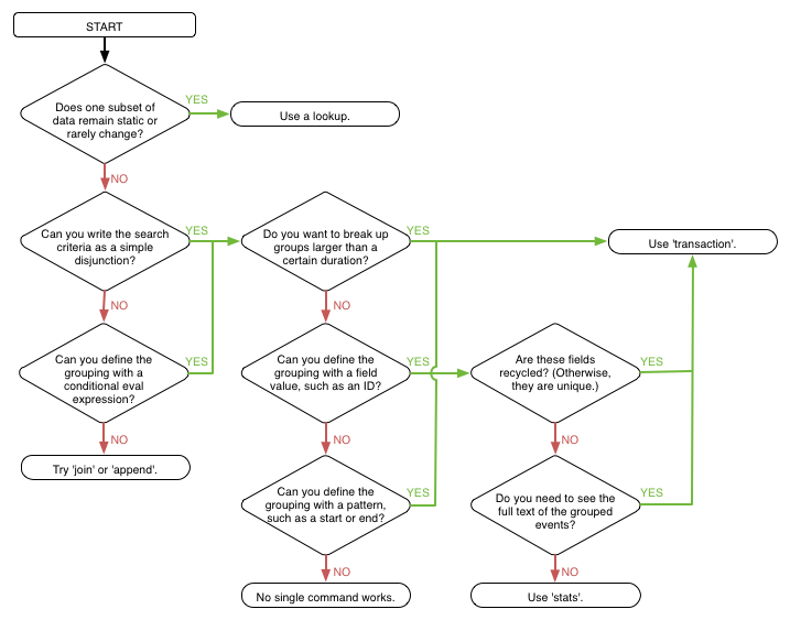

Edit: To answer your question, when to use join:

Is this flowchart PNG a creation by @aljohnson or someone else? Is there a broader context (maybe other great flowcharts) that I can see online?
aljohnson_splun
Splunk Employee
Splunk Employee
@woodcock the flowchart is from the docs, here, and the information within in it provided by @sideview (Nick Mealy)
sideview
o/ It's true the flowchart was included in the docs based on a nearly identical flowchart that I made years ago. Needs some updating probably. Maybe even an expansion of scope beyond just row aggregation. It comes in most handy when you try to explain to relatively new splunkers why they really shouldn't use join or append. Somewhat early on join clicks with new users, particularly those with SQL experience and they think of it as a primary tool. It is not. It is an edge case tool, where stats and eval are the primary tools. Short Version: If you think you need to use join, go find this flow chart and it'll probably tell you there's a better way.

I've updated my question to include a flowchart.
