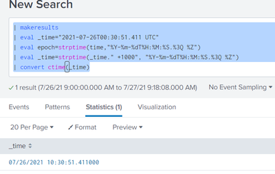

| makeresults
| eval _time="2021-07-26T00:30:51.411 UTC"
| eval _time=strptime(_time." +1000", "%Y-%m-%dT%H:%M:%S.%3Q %Z")
| convert ctime(_time)

How can I apply this to a pre existing _time field value?
venkatasri
@ebs Above SPL replaces _time at search-time but not permanent to indexers.
