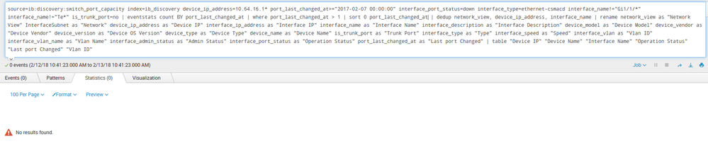

Elliott - The fact that nothing useful is happening is the very reason I'm asking how it should be done, so thank you for your detailed response - much appreciated! Unfortunately, with the search built that way, no results are found. Here's a screenshot showing this, and another of all the data with an example of the duplicates I want to show outlined.

Just to make sure I understand what's going on under the hood - do you also get 0 results when you run only this:
source=ib:discovery:switch_port_capacity index=ib_discovery device_ip_address=10.64.16.1* port_last_changed_at>="2017-02-07 00:00:00" interface_port_status=down interface_type=ethernet-csmacd interface_name!="Gi1/1/*" interface_name!="Te*" is_trunk_port=no
| eventstats count BY port_last_changed_at
| where port_last_changed_at > 1
| stats list(_raw) AS event BY port_last_changed_at
Don't add any renames or tables or anything - just see if that alone is already junking it up. Let me know what the output is, and I'll try to help from there.
