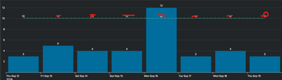

How can I remove ONLY the overlay Total on a visualization?
ashidhingra
How can I remove ONLY the overlay Total on a visualization? TIA

ashidhingra
index=
| bucket span=1s _time | stats count by _time | timechart max(count) AS Peak_TPS span=1d
| eval overlay=10
I want to remove the number display on overlay

ashidhingra
  1. I dont want to remove the overlay. I only want to remove the number 10.

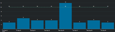

When using dashboard studio currently there is no option for this.
dataValuesDisplay("off" | "all" | "minmax")offSpecify whether chart should display no labels, all labels, or only the min and max labels.
https://docs.splunk.com/Documentation/SplunkCloud/9.2.2406/DashStudio/chartsBar
I have even tried putting the overlay into the y2 axis and the dataValuesDisplay is a higher level option so impacts all axis.
    "type": "splunk.column",
    "dataSources": {
        "primary": "ds_TNxdC2O9"
    "containerOptions": {},
    "showProgressBar": false,
    "showLastUpdated": false,
    "title": "Column Chart",
    "description": "Overlay Test",
    "options": {
        "y": "> primary | frameBySeriesNames('regular','_span')",
        "y2": "> primary | frameBySeriesNames('overlay','_span')",
        "overlayFields": [
            "overlay"
        "dataValuesDisplay": "all"
    "context": {}
ITWhisperer
Yes, Studio is not a good choice for anything vaguely sophisticated!
