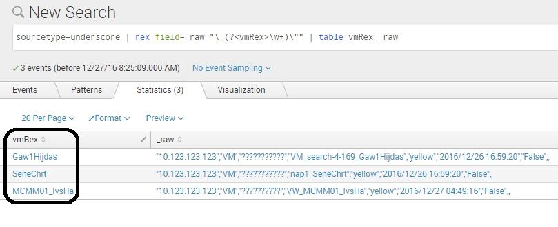

inventsekar
please check this rex..
your search | rex field=_raw "\_(?<vmRex>\w+)\"" | table vmRex _raw
as shown on this pic, its picking two texts, but one text contains extra words(the underscore was not proper i think). it may work properly on your system. please check it..
