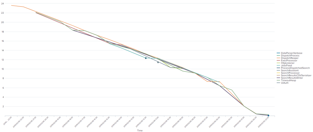

I have a timechart visualization and I would like to change the order of the number that are in the Y-axis from descendant to ascendant.
As you see in the picture, it goes from 3 - 6 - 9 - 12 and instead I would like something like this 24 - 21 - 18 - 15.

@danielgp89 Can you try the following run anywhere example based on Splunk's _internal index?
1) Simulates your current scenario with Timechart command
index=_internal sourcetype=splunkd log_level!=INFO NOT (component IN (Periodic*,Metrics*))  earliest=-1d@d latest=-0d@d-1s
| eval duracion=strftime(_time,"%H.%M")
| timechart max(duracion) as duracion by component limit=20 useother=f usenull=f
2) Uses stats to bucket events over time and then chart to transpose as needed. String Time has been used instead of Epoch time to reverse the chart.
| bin _time span=1h
| stats max(duracion) as duracion by _time component
| eval Time=strftime(_time,"%Y/%m/%d %H:%M")
| chart max(duracion) as duracion by Time component limit=20 useother=f usenull=f
| reverse
PS: Since duraction is HH.MM I have taken 24 hour data (I have picked Previous Day instead of current time window, so that chart does not change everytime we run query on Splunk's _internal index which is constantly being written)

danielgp89
@niketnilay Thanks so much for your time and response!
That was exactly what I was looking for.
Best Regards!!

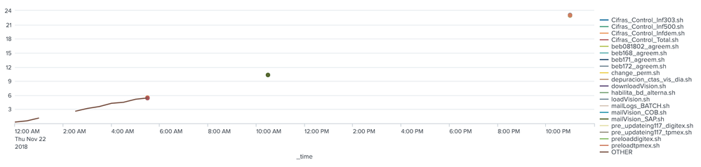

danielgp89
No @chrisyoungerjds I didn't set anything.
Look! Here an example of how does the _time match with the duration field that I created

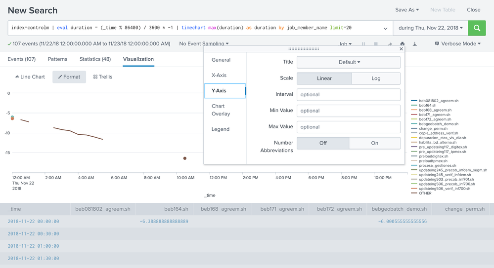

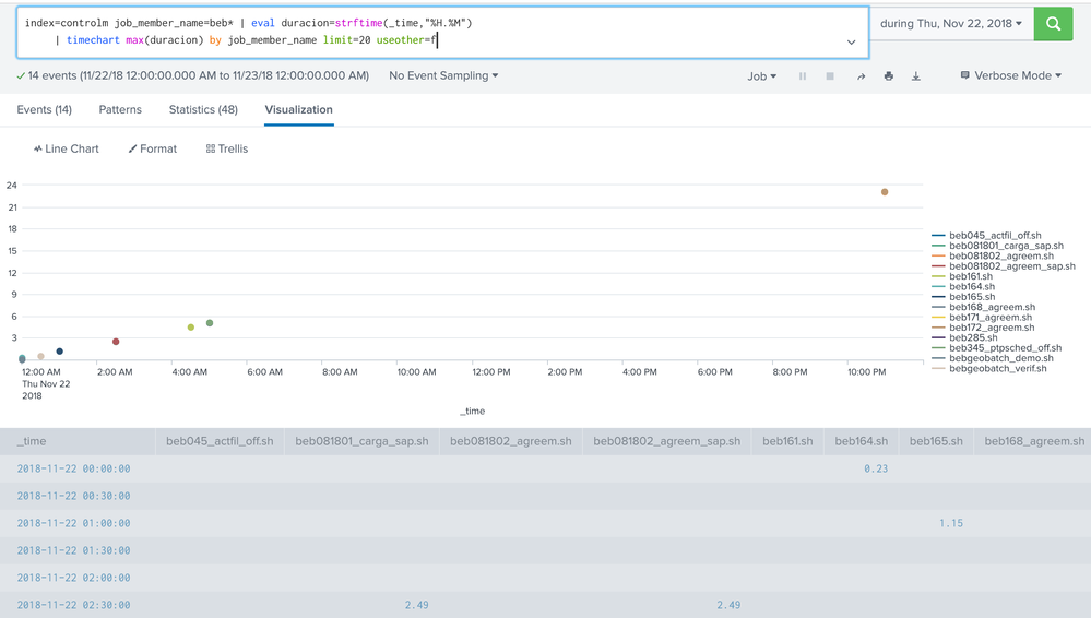

danielgp89
Thanks a lot for your help @chrisyoungerjds! hehe but doesn't work either.
That query decomposed my data. It supposed that the Y axis is the hour where the event has executed, but with this query it display me another data!
Original Query!
With Suggest Query!
chrisyounger
With my query it appears that you have set the "Format" > "Y-Axis value" on the chart - which is why its not appearing correctly.

chrisyounger
Sorry I had a typo. Try this: index=controlm | eval duration = (_time % 86400) / 3600 * -1 | timechart max(duration) as duration by job_member_name limit=20

Also @danielgp89 your time conversion is a bit dodgy. You should probably do this:
