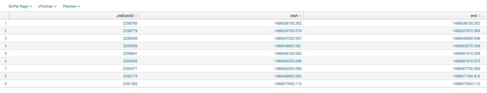

It worked fine:
index=main sourcetype=app-gmr eventtype=start_job OR eventtype=end_job
| table _time ssnservice eventtype jobId JobExecID
| join jobId [ search index=main sourcetype=app-gmr INFO job read was already scheduled
| rex field=_raw "\]: {} (?.*) with id (?\d+) " ] | **stats earliest(_time) as start latest(_time) as end** by JobExecID
But how can I format the _time to "readable" value?

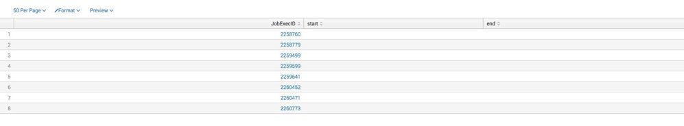

I tried:
| join jobId [ search index=ssn sourcetype=app-gmr INFO job read was already scheduled
| stats earliest(strftime(_time,"%F %H:%M:%S:%3N")) as start latest(strftime(_time,"%F %H:%M:%S:%3N")) as end by JobExecID
But I got:
ehudb
Contributor
Formatting the time to human readable:
|convert ctime(start) |convert ctime(end)
